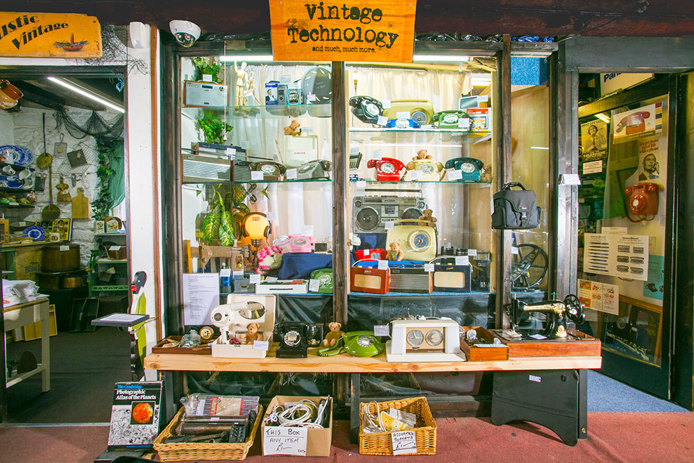

Header image: the Vintage Technology Workshop. Courtesy of Aston Sharman.
