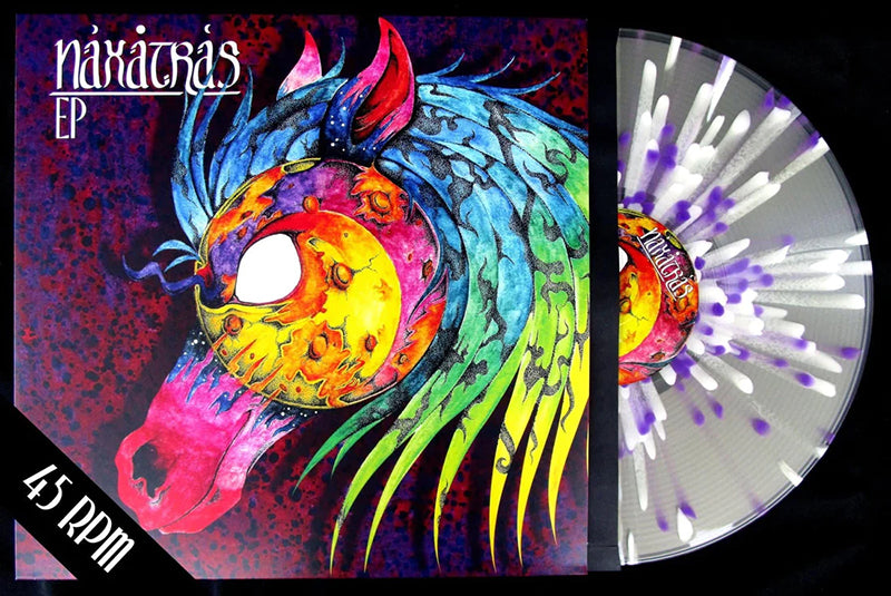

While most sample records will be near-identical to each other and to the test pressings, one or two may have a strange defect. In that case, more samples are taken from the same pallet. The aim is to locate the extent of the defect occurrence. It may prove to only affect three or four records, usually the ones right next to the original defective sample. These are weeded out and destroyed.
Special attention is required when signs of shipping damage exist. In the case of that washing machine incident (true story), although only about 40 records had obvious damage, another 20 next to them were badly warped, which could only be noticed after opening them one by one and removing the records from the seemingly intact sleeves. This was probably because the washing machine (or submarine parts) which fell on the records when the truck swerved to avoid a suicidal driver, actually stayed there, leaning against the records for another three days of bumpy roads, diesel hum, and country music, bending the neighboring records out of shape…!
Both record and sleeve are scrutinized for defects—all the more painstaking when they are as elaborate as this release!
