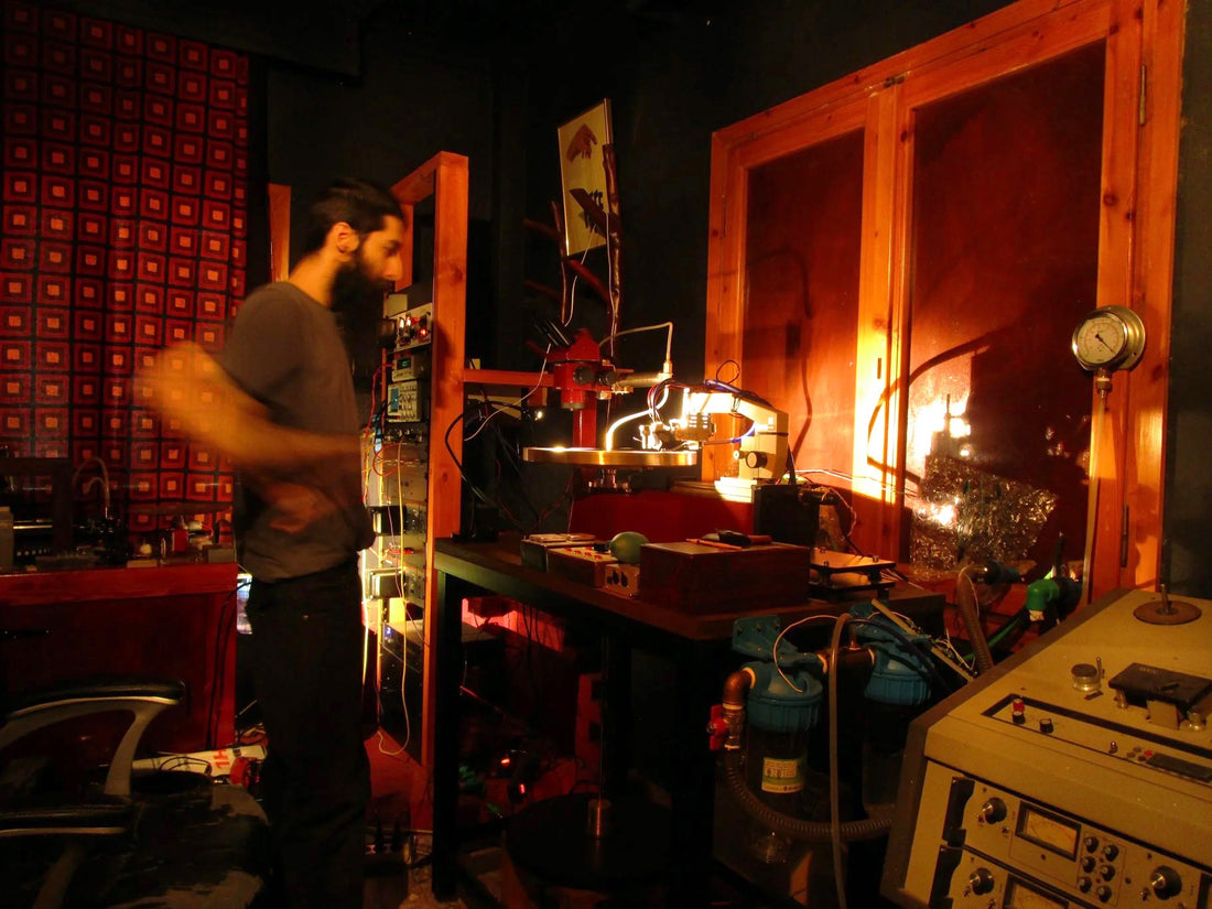

The disk recording lathe, as its name implies, is a machine tool related to the lathe used for metalworking and screw cutting in particular. It is a very accurate mechanical assembly, which clamps and rotates the workpiece (a blank disk) at a steady speed while feeding a cutting tool across its surface to cut a spiral groove. What may appear as a crude and primitive process to the uninitiated, is the grandmother of modern micromachining, resulting in one of the most accurate products humans can make.
A Neumann-based disk mastering lathe with many upgrades and a preview-head tape machine on the side. Photograph courtesy of Magnetic Fidelity.
The feed rate, rotational speed, depth of cut and many other parameters are often adjusted through control units which even permit some limited degree of automation and repeatability. The cutting tool is held in the cutter head, which can impart vibrations to the tool in proportion to an electrical signal driving it. The audio electronics include, as a minimum, the pre-emphasis module (which implements the RIAA recording characteristic) and a cutting amplifier, which is essentially a power amplifier designed to drive a cutter head. The audio electronics often also extend to signal processing units, cutter head protection units, instrumentation to monitor signal level and the coil temperature of the cutter head transducer system, and possibly more. The complete system, despite its complexity, does not know or care what happens upstream of its inputs.
A master disk in the process of being cut on a heavily modified Neumann-based disk mastering system. Photograph courtesy of Magnetic Fidelity.
