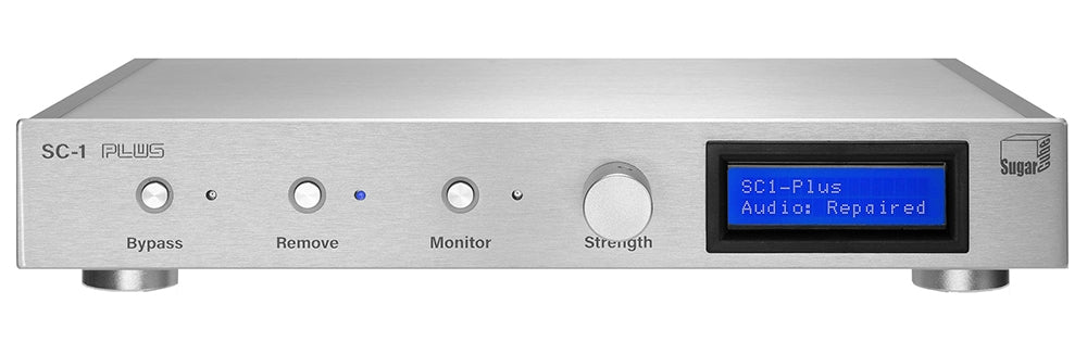

Late last year the opportunity came up to get ahold of a barely-used SugarCube SC-1 Plus through an online auction at a substantial discount. As I write this, I’ve had it for about a month and am still in the process of learning how to use it properly. It’s not that it is a difficult unit to use, but learning the nuances of the different levels of click and pop reduction is very important in getting the most out of it.
SC-1 Plus in black. From the SweetVinyl website. SC-1 Plus in black. From the SweetVinyl website.
The reasons I wanted the SC-1 Plus over other models in the company’s lineup were the unit’s coaxial digital output (which I send to my DAC), and its USB output that would allow me to record digitally to a computer. The SC-1 Plus and SC-2 Plus also have a newly-added SVNR (SweetVinyl Noise Reduction) feature which I have not yet explored; it is targeted to reducing surface noise on tapes and older records.
The SC-2 Plus adds the ability to record the audio to a USB storage device, complete with track splitting and metadata tagging. The SC-1 Mini and Mini/Phono (with phono stage) offer only the click and pop removal, and the SC-2 Mini and Mini/Phono add the recording functions. All SugarCubes can be remote-controlled using a web browser on any type of computer, or through an app on a smartphone or tablet, which duplicates the front panel controls. SVNR is accessed only through the web or app interface.
The SugarCube is typically placed between a phono stage and preamplifier, although it can also be inserted into a tape monitor or external processor loop. The unit has a high-quality relay inside that you can use to completely bypass the SugarCube electronically, so it is safe to leave it between your phono stage and preamp without any sonic degradation. The SugarCube connects to your home network via Ethernet or Wi-Fi in order to receive software updates and provide remote control features and, for the SC-2 units, to retrieve metadata from Discogs for tagging recorded tracks.
I plan on using the SugarCube for real-time music playback, and more importantly, for digitizing many of those unusual and rare recordings that I own so that I can play them outside of my main system. While I haven’t yet set up my audio computer for recording digitally yet, I have had a month to run the SugarCube through its paces and see how it works.
And I have to tell you, it works. Brilliantly!
This is by far the best noise reduction I have ever used on records. From faint ticks to large pops and clicks, the SugarCube is eliminating them and not leaving any artifacts behind! The one thing I am marveling at right now is how I am able to play some records I had given up on, including a couple of abysmal recent “Near-Mint” purchases that were in horrid condition.
