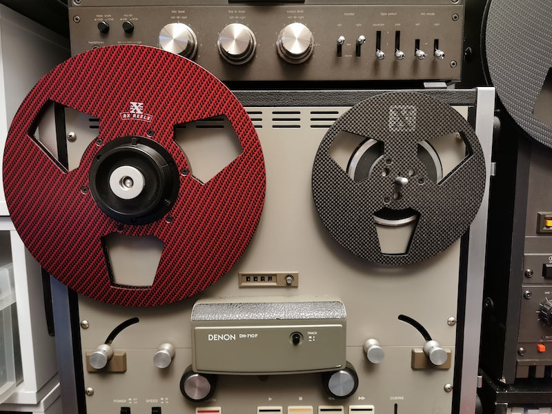

Header image: RX Reels’ 10-inch and 7-inch reels on a Denon DH-710F tape deck. All images courtesy of the author.
