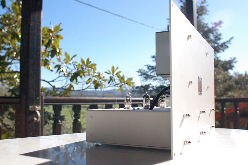

Several vacuum tube reverb units and power supply units at the assembly line at the Agnew Analog Precision Engineering Laboratory.

A row of vacuum tube reverb units on the bench.
Pairs of triodes are used to form differential amplifiers, with the transformer primary as the plate load, a single cathode resistor shared by both triodes in the differential pair, and a transformer or transducer directly tied to the grids. It sounds very simple, but it all needs to be very carefully calculated. The spring transducers are electrically floating (not connected to ground), driven in a balanced differential manner and likewise collected at the pick-up end. There is no negative feedback used in the circuit, relying instead on very carefully-matched pairs of extremely linear triodes with a mu of 25: The RCA 9002. Never heard of it? Uncle Sam did, and sold me his leftover stock. These are single triodes (as opposed to the 12AX7, which is a dual triode, containing two triodes within the same glass envelope), with a small 7-pin base and pleasantly low capacitance, with the lowish mu rendering the Miller Effect insignificant. This allows very- ide- andwidth designs to be accomplished, if the transformers are designed appropriately.
