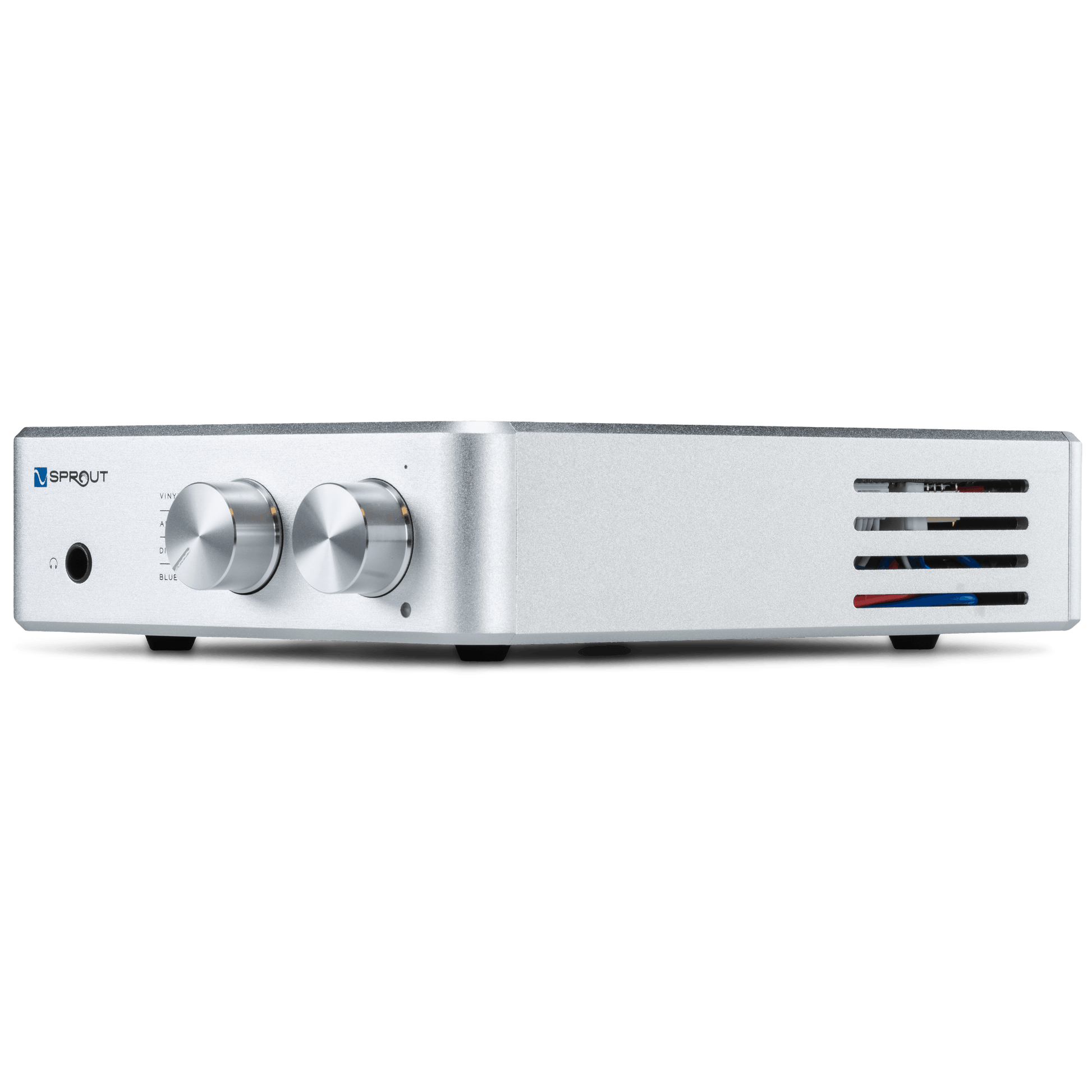

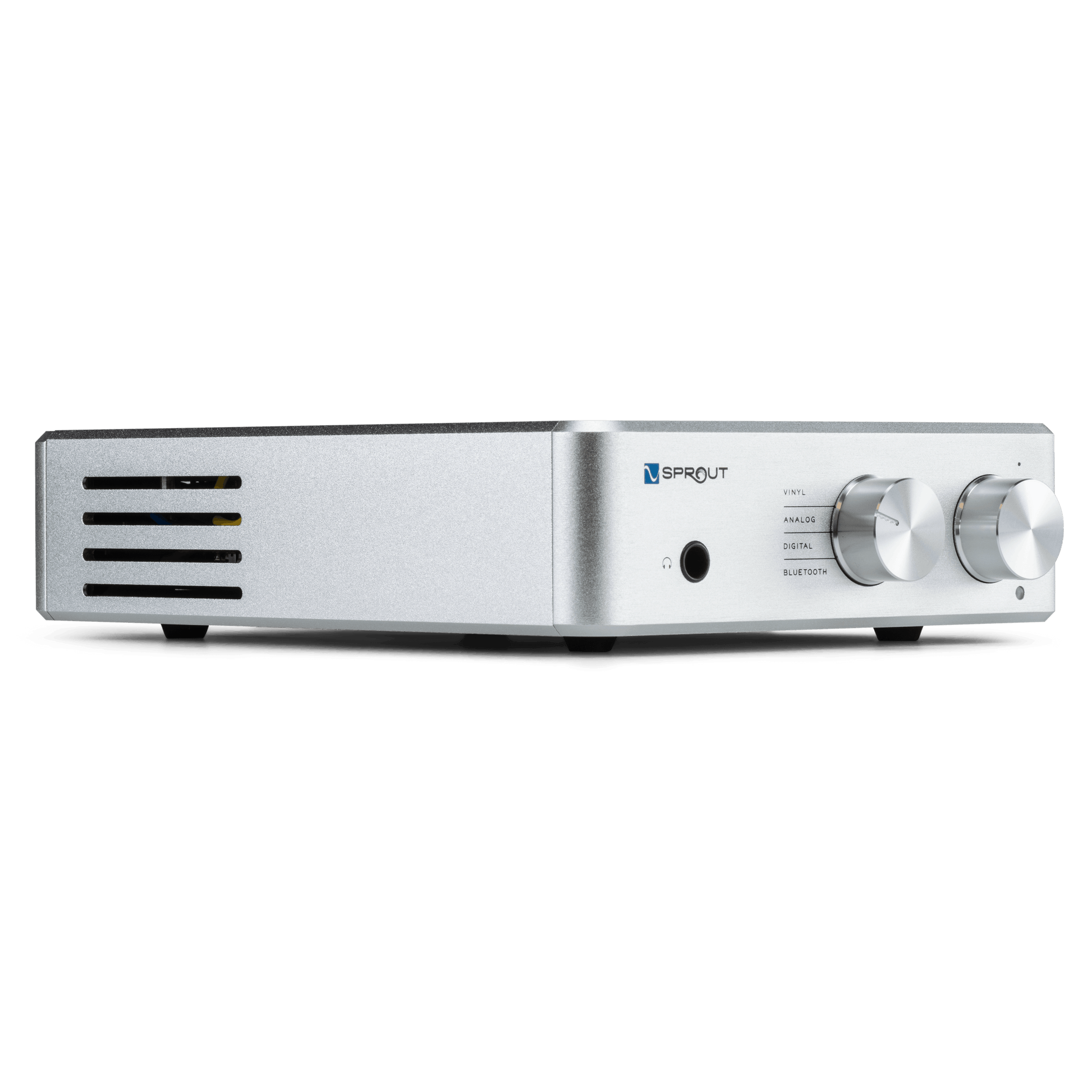

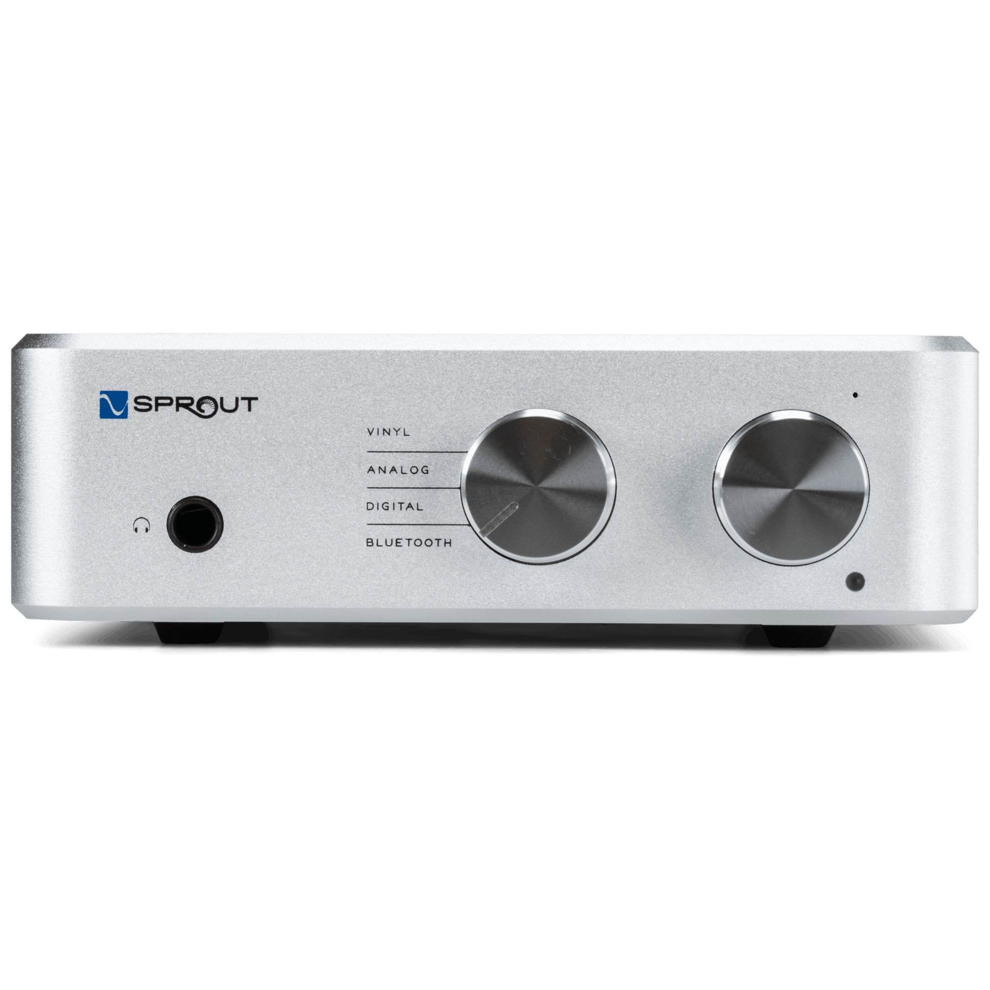

As PS Audio's newest, first-tier integrated amplifier, Sprout100 represents our vision of a simple, elegant means of playing music at home.
Sprout represents our vision of a simple, elegant means of playing music at home. We created it for those of us who want quality sound without the hassles that sometimes come with it. Sprout features a phono preamplifier for vinyl, a Bluetooth receiver for music streamed from smartphones, a high-quality hi-res DAC to handle anything stored on a computer, enough power for any speaker, and a headphone amp that drives even the toughest loads. Roughly the size of a large novel, Sprout100 is a source of music for those who want quality sound without the hassles that come with it.

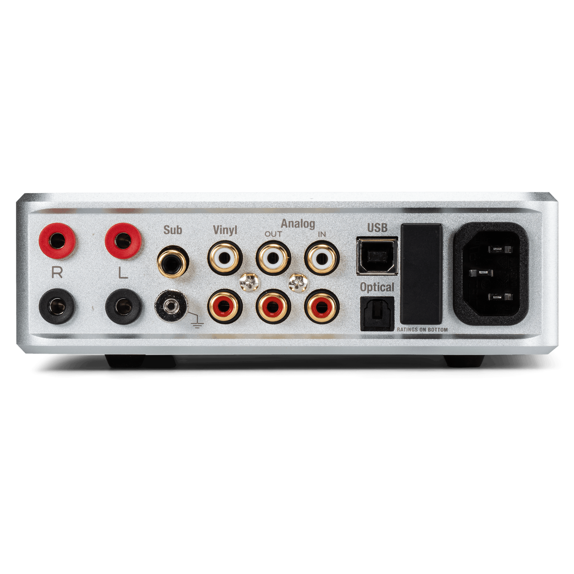

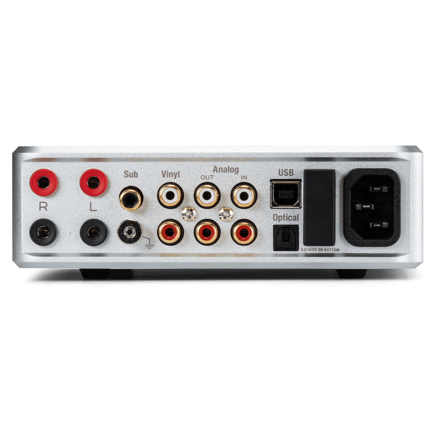

Specifications - Sprout100
Physical |
| Unit Weight | 2.9 lbs [1.3 kg] |
| Unit Dimensions | Width 6.2", Height 1.9", Depth 8.2" (chassis only, not including knobs) or 9.2” (including connectors and knobs) |
| Shipping Weight | 5lbs [2.2 kg] |
| Shipping Dimensions | Width 10.5", Height 5", Depth 14" |
Power requirements |
| Voltage Options | 100-240 VAC, 50-60Hz, Auto-Detect |
| Power Consumption | 280W Maximum |
| Mains Power Input | IEC C14 |
Phono Audio Input |
| Connector | 1 Stereo Pair, Phono RCA |
| Cartridge type | Moving Magnet |
| Cartridge Output | 3mV-10mV (5mV recommended) |
| Cartridge Loading | 47KΩ (100pF) |
| EQ Type | RIAA |
| Gain | +40dB |
| S/N ratio | >84dB A-weighted (analog output) |
Analog Audio Inputs |
| Connector | 1 Stereo Pair, Line Level RCA |
| Maximum Input level | 2.1VRMS (+6.44dBV) |
| Input impedance | 10KΩ |
Analog Audio Output |
| Output level, maximum | 3.0VRMS (+9.5dBV) |
| Output Max Gain (using Analog Inputs) | 8.45dB |
| S/N ratio | >105dB (3VRMS ref) |
| THD (Analog) | <0.01% (1VRMS, 1KHz) |
S/PDIF Digital Input |
| Connector | Optical (Toslink) |
| Format | PCM (96KHz max), 24 bits |
USB Input |
| Connector | USB “B” Type |
| Format | PCM (384KHz max), 24 bits, DSD64 (DoP), DSD128 (DoP) |
| Transfer mode | Asynchronous |
Bluetooth |
| Antenna | Built in |
| DAC | Uses Sprout's built in asynchronous DAC over S/PDIF (ESS Sabre 9016 DAC) |
Stereo Power Amplifier Output |
| 8Ω loudspeakers connected | 50 watts per channel, both channels driven |
| 4Ω loudspeakers connected | 100 watts per channel, both channels driven |
| THD (Speaker Output) | <0.01% (1W, 1KHz into 4Ω) |
| Frequency Response | +/- 1dB (1VRMS out, 20Hz – 20Khz into 4-8Ω) |
| Signal to Noise | >100dB at max power into 4Ω |
Headphone Output |
| 32Ω headphones connected | 500mW |
| 300Ω headphones connected | 125mW |
| THD | <0.01% (1KHz, 50mW into 32 Ω) |
| Signal to Noise | >105dB at max power into 300Ω |
