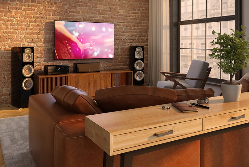

Header image of Yamaha Aventage RX-A2A Dolby Atmos receiver and components, and all images courtesy of Yamaha.
