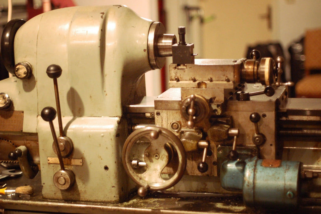

The 1954 Hardinge HLV super-precision lathe in the new building.These massive chunks of cast iron offer very few possible lifting points, and to further complicate things have levers, dials, handwheels, and shafts protruding in all directions!

The apron of the Hardinge HLV lathe, with longitudinal feed wheel, cross-feed ball-crank handle, power feed motor, feed clutch levers, half-nut engine lever, carriage lock lever and sight glass for maintaining the oil level.Our few neighbors were, by now, permanently standing around our properly, staring in disbelief as truckload after truckload of impossibly obsolete chunks of old iron were being hauled in. One of the crew members said he even saw money being exchanged between them, presumably bets being placed about what on earth all these machines were for. “Do you think they’re building a nuclear power plant?” “Perhaps they work for the government!” “No, I bet they’ve just completely lost it and collect old useless things that nobody needs!”
