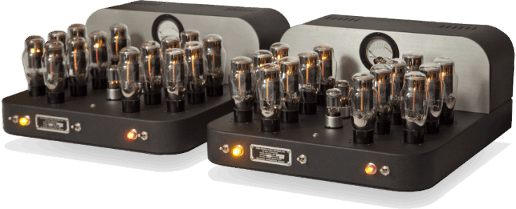

There’s a particular magic in the simplicity of a direct path—whether it’s a live microphone feed straight to the control room, or the cleanest signal from source to speaker. Most of us in high-end audio spend our lives chasing purity. That’s why output transformerless, or OTL, tube amplifiers of the past have always fascinated me.
If you’ve never listened to one, you owe it to yourself—at least once—to experience what a tube amp sounds like when it doesn’t have a big hunk of iron between its tubes and your loudspeakers.
Back in the early days of tube amplification, transformers were essential. Tubes naturally operate at high voltages and low currents, while loudspeakers want the opposite—lots of current at relatively low voltage. Transformers were the matchmakers, stepping down the voltage and stepping up the current so the amp and speaker could work together. It was clever, necessary, and it worked. But it wasn’t perfect.
That transformer adds its own character. It stores energy. It can saturate. It can smear transients and dull detail. If the transformer isn’t superb—and that means heavy, expensive, and hand-wound—then it’s the bottleneck. The choke point.
OTL designers looked at that and asked: what if we just got rid of it?
The idea’s been around since the 1950s. The best-known early champion was Julius Futterman, who developed a topology where multiple tubes were wired in parallel, often in push-pull, to deliver enough current to drive a speaker directly. It wasn’t easy. Without a transformer to isolate things, the amp’s output floated near 100 volts or more above ground. And if one tube failed, the amp could go unstable or even take out a speaker.
The first time I heard an OTL amp on a properly matched speaker—an old high-efficiency electrostatic—I was pleased. The immediacy, the speed, the openness. You don’t get that kind of transparency out of transformer-coupled tube amps, no matter how good. It’s like pulling gauze off the music. The leading edges snap. There’s no fuzz around the notes. Just presence.
But OTLs aren’t for the faint of heart. They run hot. They tend to be huge—because you need all those tubes to do the job that one transformer used to handle. And they don’t like tough speaker loads. Anything below 8 ohms can be dicey. Some designs got clever with capacitor coupling or hybrid tricks to make them more stable, but it was always a balancing act.
That’s the engineering lesson: everything’s a tradeoff. Transformers are a compromise, but so is leaving them out. It comes down to what matters most to you—and what you’re willing to live with. For me, I still believe in the direct path. Direct-coupled solid-state circuits. Planar speakers with minimal crossover interference. Fewer barriers between the music and your ears.
Because sometimes, the simplest connection tells all.
