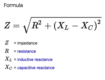

The simplest way to think about impedance is to consider it an opposer. The higher the impedance the greater the opposition to alternating current. A wire has almost no impedance and thus offers little to no obstruction to the passage of a musical AC signal. On the opposite side of the scale, air has very high impedance (resistance) to passing electrical signals. Basically, not much electrical energy passes through air (its resistivity is approximately 2×1016Ω⋅m).
