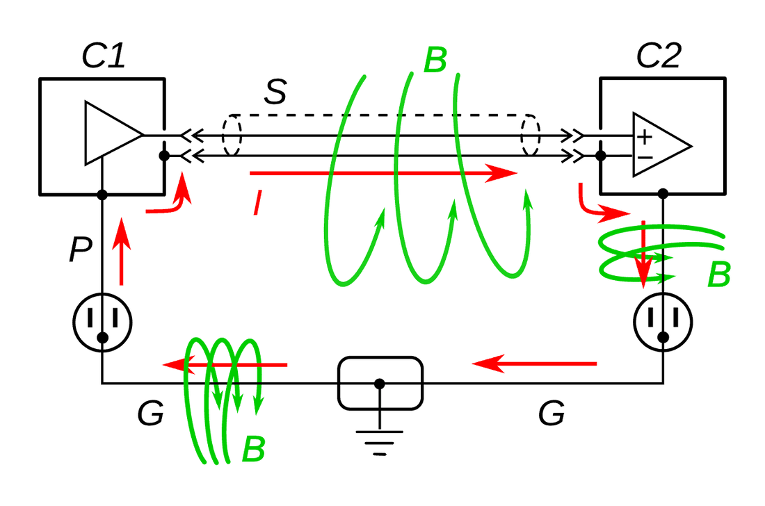

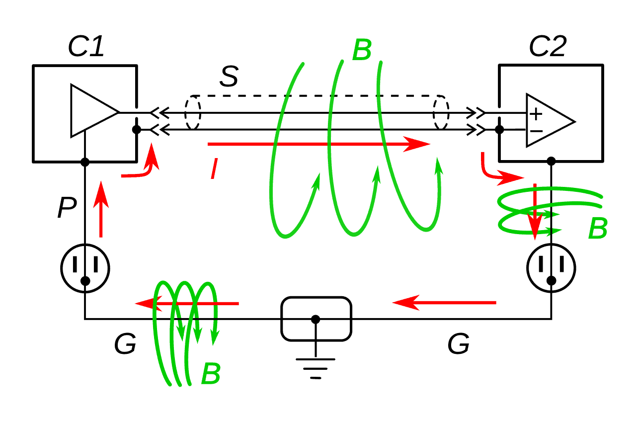

A major cause of ground hum is a ground loop. This can occur when an audio system is connected to ground at more than one point, such as when the various components in a system have their AC power cords plugged into outlets in multiple locations. It can also happen because the components have their grounds connected via their audio interconnects; for example, the interconnects between a preamp and power amp.
So, when I would get ground hum, the first thing I would try to do was to break the ground loop. Sometimes I got lucky and could just happily plug everything in…preamps, phono stages, monoblock amps, turntables, CD players, at times electrostatic speakers all at once…and the system would be noise-free. Other times…hum hum hum, aarrgghh!

Ground loop diagram. Courtesy of Wikimedia Commons/Chetvomo.
