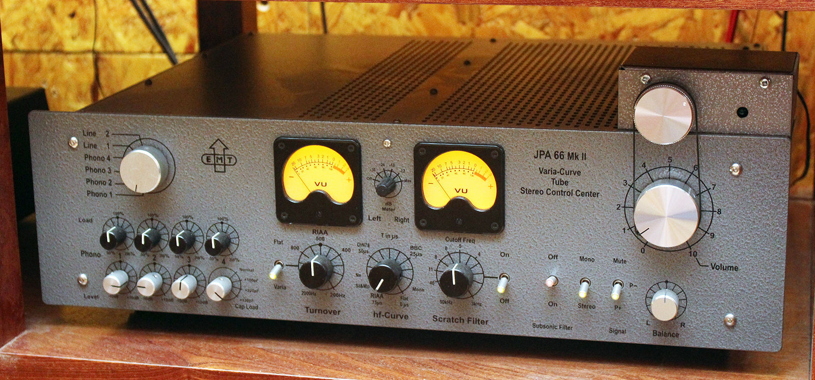

Analog VU meters with bouncing needle displays have long been present on audiophile components, particularly amplifiers and tape decks. Think of the 1970s and 1980s vintage gear made by companies such as McIntosh, Audio Research, Luxman, Nagra, Phase Linear, and Accuphase. Simply stated, VU meters indicate the average level of an audio signal and provide an indication of perceived loudness. As McIntosh explains on its website, its familiar blue-paneled amplifier meters protect speakers from overload by “allow[ing] the monitoring of sound level balance and output level . . . .”

That’s not to say that analog needle display VU meters have been abandoned. Quite to the contrary, Mcintosh, Audio Research, Luxman, Nagra, Accuphase, Yamaha, and many other manufacturers still prominently use them, with the most iconic perhaps being those found on McIntosh’s components. The analog VU meter needle displays on Dan D’Agostino Master Audio Systems components, aesthetically inspired by Breguet and Tourbillon watch faces, are arguably the most gorgeous.
