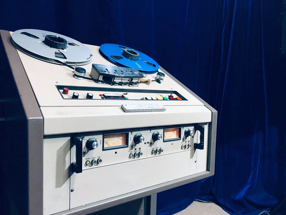

Header image: The JH-110 in the variable profile cabinet. Photo courtesy of Sabik Chaparro.
