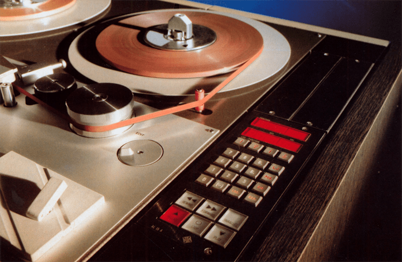

M15A with optional shelf. From an original Telefunken M15A product brochure.
