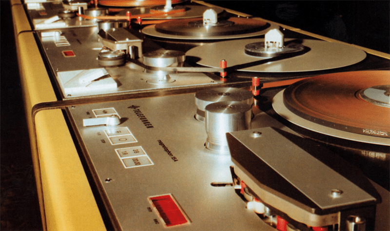

A Telefunken M15A in use at Town House Studios, London, 1978. Photo courtesy of Philip Newell.
