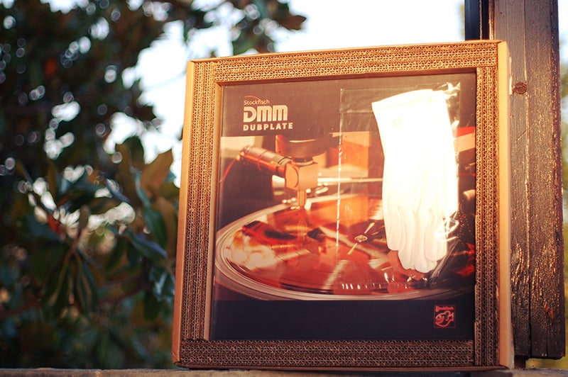

The DMM Dubplate Vol. 1 comes with a protective box, carrying bag and even white gloves for handling.
