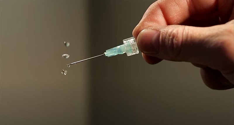

Acoustic manipulation is a technique that can be used in medical applications, such as controlling a miniature camera within a human body, or removing a kidney stone. Call it “acoustic levitation.” It works by using multiple ultrasonic transducers whose phase can be controlled, resulting in interference patterns that can trap and move small particles.

DR. RW: A lot of emerging drug compounds have very low solubility, since they are normally very stable crystals. Levitation has enabled us to make high-solubility glassy forms in many cases. This is an active area of pharmaceutical research being supported by the National Institutes of Health, and industry, along with university research labs.
CB: Levitating pharmaceutical compounds in an x-ray beam allows us to understand where the atoms are during the compound’s transition from a droplet to a glass. If the drug compound crystallizes, it loses its effectiveness, so by being able to understand why and how it remains in a glassy state is important in designing effective pharmaceutical formulations with high solubility.
