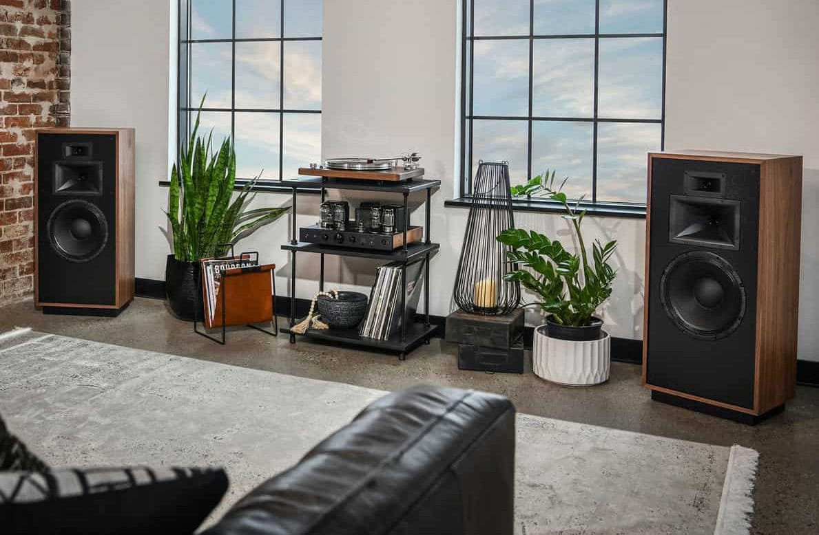

Header image: Klipsch Forte IV loudspeakers.
