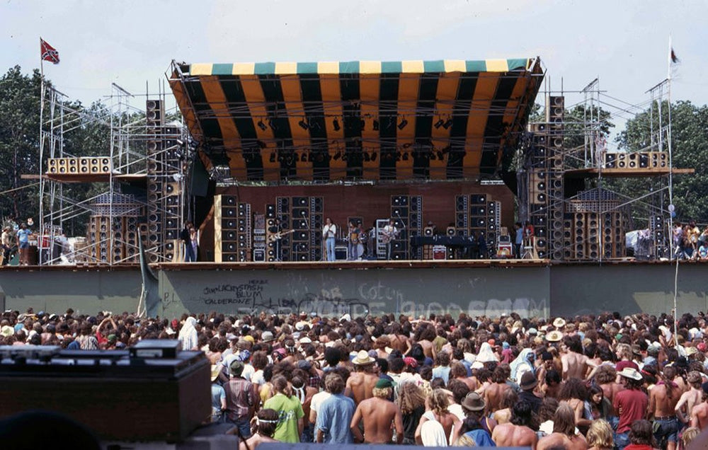

For Summer Jam, the then-fledgling pro audio company Eventide was hired by Bill Graham’s FM Productions company to fix the problem of the live sound from the stage being out of sync with the speakers placed farther out into the audience. They brought three DDL 1745 Digital Delay Line units for use in the event’s massive outdoor sound reinforcement system. The DDL 1745 was the world’s first piece of digital professional audio hardware, and Summer Jam was the first time it was used. This unit would revolutionize large-scale sound system quality.
Eventide DDL 1745 Digital Delay Line. Courtesy of Eventide Audio/A.Agnello.
The Eventide DDL 1745 had the capability of up to 200 milliseconds of adjustable delay time. In the Summer Jam sound reinforcement system, besides the on-stage speakers, there were four additional speaker towers that were located about 200 feet from the stage, and more towers that were located about 400 feet farther away from those (around 600 feet from the stage). Previous to the use of these delay units, the sound from the towers farther away from the stage would be noticeably out of sync with the main towers and with the onstage visuals, because of the speed of sound as it travels through the air (about 1,100 feet per second), and the fact that sound travels much more slowly than light.
The DDL 1745 was a brilliant solution to the problem. 350 milliseconds of delay was applied to the sound towers located 400 feet away from the stage, and 525ms of delay was added to the sound coming from the farthest towers. As a result, the sound from the onstage amplifiers and PA system and the sound from the more distant speakers arrived to listeners who were far from the stage at approximately the same time, giving everyone a much better audio experience.
The Eventide DDL 1745 incorporated a module had a bunch of 1,000-bit shift-register integrated circuits. Yikes! who knew there were computer chips in 1973? And yes, these units were expensive, each one was, as the Eventide website puts it, approximately the cost of a new car back then. Another benefit of the more balanced sound was that the people in front were not blown away by the increased volume that would have been required by the attempt to reach the people in back. This new sound application became the standard for all large events going forward. To this day, such sound towers are commonly known as “delay towers.”

The crowd at Watkins Glen and the speaker delay towers. Courtesy of Eventide Audio/A. Agnello.
