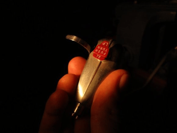

General Electric VR-II: this is a vintage monophonic moving iron cartridge, featuring two styli, one with a large tip radius for 78 RPM records and one with a small tip radius for 33-1/3 RPM "microgroove" records.
