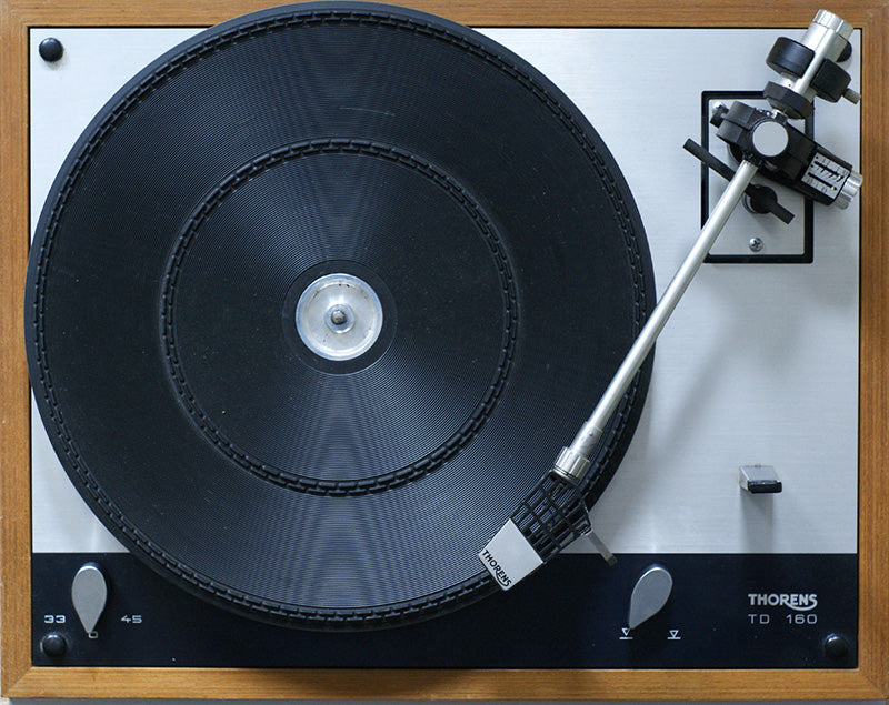

The Thorens TD 160 is a highly regarded, classic turntable, which was manufactured in Lahr, Germany, from 1972 to 1988. In 1976 the TD 160 Mk II was introduced and the TD 160 Super arrived in 1982. All variants are simple and well-designed, offering a very high level of performance straight out of the box. All versions come fitted with the Thorens TP16 tonearm, in one of its implementations, which is already quite decent, but there is ample room for improvement.
The platter is a two-piece zinc alloy casting, with a precise shaft press-fitted to it. The center spindle measures exactly 7.24 mm, ensuring a tight fit in the record hole for accurately centered reproduction according to the IEC60098:1987 standard for phonograph records.
The center bearing is comprised of a couple of plain bronze bearings in a housing, terminating in an accurately machined cone which engages a matching cone at the bottom of the shaft. No ball! Friction and noise are exceptionally low, while accuracy is high, as expected from a Swiss manufacturer (at least this was where they started!) of precision parts.
The motor is a 16-pole synchronous AC unit, with a clutch pulley to ensure a smooth start. By now, the original capacitors on these units have developed a rather high leakage current, causing the motor spindle to vibrate as soon as it is plugged in with the switch in the "0" position. Just touch the top of the pulley and you can feel it. This is not normal, and can easily be rectified.
The platter is belt driven and the two-step motor pulley is configured to offer the correct ratio for 33 1/3 and 45 rpm.
