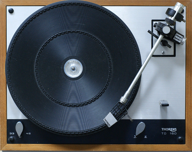

Modified Thorens TD160 with SME 3009 and Van den Hul MC Two cartridge, with a test recordModified Thorens TD 160 with SME 3009 and van den Hul MC-Two cartridge, with a test record.
What follows is the story of the restoration, modification, assembly, calibration and testing, of some components, which, if used properly, can result in a highly accurate phonograph disk reproduction system.

The Thorens TD 160 is a highly regarded, classic turntable, which was manufactured in Lahr, Germany, from 1972 to 1988. In 1976 the TD 160 Mk II was introduced and the TD 160 Super arrived in 1982. All variants are simple and well-designed, offering a very high level of performance straight out of the box. All versions come fitted with the Thorens TP16 tonearm, in one of its implementations, which is already quite decent, but there is ample room for improvement.
The platter is a two-piece zinc alloy casting, with a precise shaft press-fitted to it. The center spindle measures exactly 7.24 mm, ensuring a tight fit in the record hole for accurately centered reproduction according to the IEC60098:1987 standard for phonograph records.
The center bearing is comprised of a couple of plain bronze bearings in a housing, terminating in an accurately machined cone which engages a matching cone at the bottom of the shaft. No ball! Friction and noise are exceptionally low, while accuracy is high, as expected from a Swiss manufacturer (at least this was where they started!) of precision parts.
The motor is a 16-pole synchronous AC unit, with a clutch pulley to ensure a smooth start. By now, the original capacitors on these units have developed a rather high leakage current, causing the motor spindle to vibrate as soon as it is plugged in with the switch in the "0" position. Just touch the top of the pulley and you can feel it. This is not normal, and can easily be rectified.
The platter is belt driven and the two-step motor pulley is configured to offer the correct ratio for 33 1/3 and 45 rpm.

Taking an educated guess, we could assume that a static compliance of 28 μm/mN would translate to a dynamic compliance of half this value, so 14 μm/mN or somewhere around there. This brings us to 10.36 Hz, which is exactly where we would ideally want to be. A tonearm/cartridge resonance of approximately 10 Hz is recommended, which could be stretched to a range from 8 Hz to 12 Hz in most cases, without side effects.
An effect of this resonance is that it results in a mechanical high-pass filter, attenuating below the resonant frequency. This prevents the tonearm/cartridge combination from achieving a flat response down to 5 Hz.
But, what if we add more mass? Yes, we could do that and get a response flat to 5 Hz, by lowering the resonant frequency. Unfortunately, records are not perfectly flat, so if we were to do that we would get a lot of strange audible side effects which are magically tuned out once the resonance frequency reaches or exceeds 8 Hz. Exceeding 12 Hz, on the other hand, unnecessarily interferes with the phase response and increases the risk of the needle jumping if the resonance is excited by recorded sounds. As an example, the lowest fundamental of a pipe organ can be as low as 16 Hz, which can be recorded and even reproduced, as long as the tonearm/cartridge resonance is kept substantially lower. Which is how the value of 10 Hz came to be. On this particular system, the resonance was measured at 10.5 Hz, which is close enough to our predicted value of 10.36 Hz to verify the dynamic compliance assumption.
Another noteworthy aspect of performance was the rumble, exceeding the Thorens specifications of -72 dB. The bearing and motor were reconditioned and freshly lubricated with special high performance lubricants, the capacitors were replaced, the belt was replaced with a high performance type, the clutch pulley was reconditioned, and the motor was powered by a quartz-locked power supply unit, offering a dead-stable 50 Hz, clean and pure.
Moreover, rumble measurements via tonearm and cartridge will of course give slightly different readings if a different tonearm or cartridge is used. We used the silent grooves of test records (pressed vinyl) and test lacquer disks we cut in-house for such measurements. The figure of -78 dB was obtained with the final setup, including the SME tonearm and vdH cartridge, after approximately 30 minutes of running at 45 RPM. The measurements were repeated at both speeds.
Lincoln Mayorga plays Brahms, Handel, Chopin, via the Thorens TD160, SME 3009 and VDH Two.Lincoln Mayorga plays Brahms, Handel, Chopin, via the Thorens TD160, SME 3009 and VDH Two.
Finally, when the adjustment and calibration have been successful, the system is ready to reproduce some real music!
