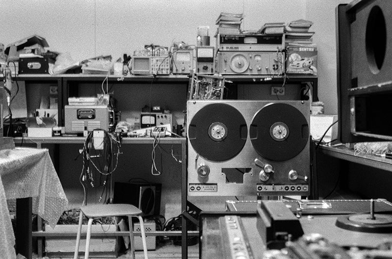

Header image courtesy of Pexels.com/Nikita Korchagin.
