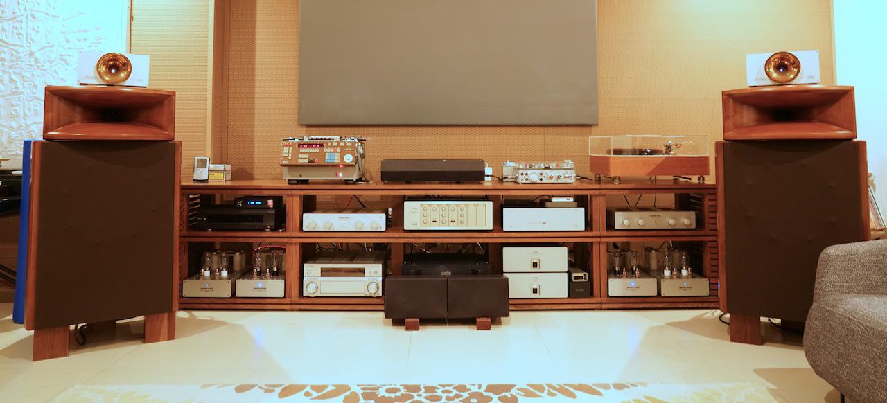

      As I feel I have finally accomplished a satisfactory result with my speakers, I have moved on to deal with the recordings that I have made over the years. I needed a master recorder for editing and playback of the tapes. The Nagra IV-S is good for neither task; its playback electronics are more of an afterthought, and it does not allow for precise positioning of the tape for editing. The Nagra T-Audio recorder was initially developed as a scientific instrument, and later adapted for the television and film industry. Due to its substantial cost when it was introduced, it was too expensive for most music studios. The listed price in 1983 was £26,000, enough to buy a modest house in London!
      Luckily, by the mid-2000s, analogue had fallen out of favor, and I was able to pick one up, fully refurbished with new heads, from Nagra for 8,000 CHF (about $8,800 US). I was attracted to its small footprint and the amazingly precise mechanical function, which makes tape editing very easy. However, the playback electronics of the machine, while competent, are not up to audiophile standard. The extensive use of 1980s-vintage op-amps and complicated compensation networks give the sound an unnatural, electronic character, although the dynamics and scale of the sound are outstanding.
      Nagra T-Audio tape recorder.
      There is now a trend for audiophiles to bypass the native electronics of professional recorders, and this was what I did. I wired the playback head with solid core pure silver wire directly to my prototype preamp, after modifying the RIAA EQ network for IEC and Nagramaster equalizations. (Most commercially available 15-ips tapes nowadays use IEC EQ, and all my own recordings use Nagramaster EQ.) It took some experimentation to optimize the frequency response, but the end result is highly satisfactory. The writeup about the modifications has been published at my group’s website (the Asia Audio Society) for those who are interested in the technical details. Tape playback avoids the pitfalls of LPs, such as distortion, noise and dynamic compression. It also sounds more natural and musical than the majority of digital recordings.
      Commercial recordings are becoming available on 15-ips reel tapes from companies such as Tape Project, Analogue Productions and others. I also have a collection of master tape copies of some of my favorite music, which I have obtained from a couple of recording engineers in Europe.
      I feel I have finally arrived at a sound that I find quite satisfactory, and I can just enjoy the music without worrying about what I need to do next (for a while).

       Adrian Wu's current system.
