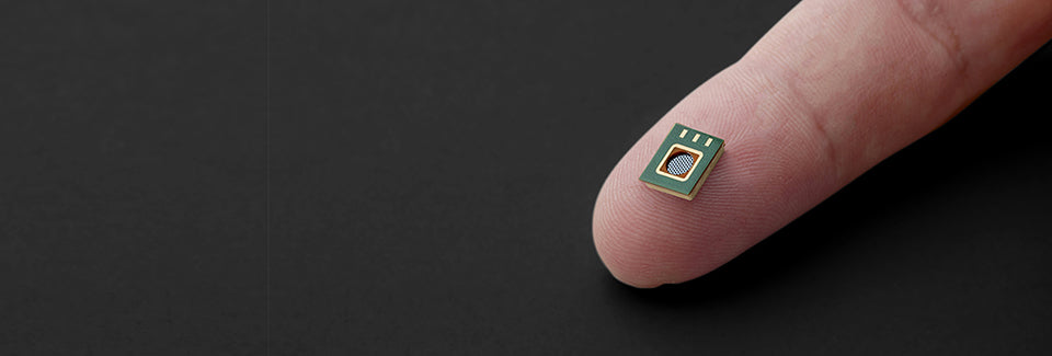

Sonic Edge is a company that specializes in MEMS miniature speaker technology. MEMS (for micro-electromechanical systems) speakers employ drivers that are fabricated on silicon chips, which can be made to be very small, and can offer advantages in audio quality, and manufacturing. Sonic Edge, based in Israel and Denmark, offers a unique modulated-ultrasound MEMS driver, a second-generation MEMS speaker that is a “one-speaker-solution,” unlike first-generation MEMS speakers that can only work as tweeters, operating in parallel with a traditional dynamic-driver speaker. Sonic Edge’s driver is based on ultrasound, where ultrasound is generated from multiple speakers, each the width of a human hair, and then converted to audible sound via a patented acoustic frequency transformer or modulator.

Sonic Edge AirDriver modules.
