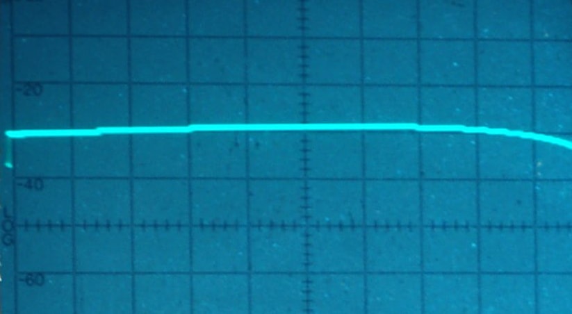

Dynamic linearity is often in itself non-linear with frequency. A circuit may have a wider linear range at some frequencies than at other frequencies within its linear frequency pass band.
But, is it measurable? Yes, of course.
Dynamic linearity can be either measured for an amplification device such as a tube or transistor alone (the inherent linearity of the device) or for a complete circuit, with the latter being more useful to the consumer and the former more useful to the engineer.
The dynamic range specification of an amplifier can offer a hint about its dynamic linearity, but it will not tell us the whole story, as it is often just the range between the noise floor and the “maximum output” of the amplifier, whatever that means (there are several different opinions on how to define “maximum output”).
Distortion specifications may offer another hint regarding dynamic linearity, but again, they are far from the whole story. Given that distortion figures can vary with signal level and frequency, a single measurement can be made at a convenient signal level and frequency where a particular circuit will exhibit the lowest figures. This is just specsmanship and does not tell us much about the sound or performance of that circuit. Plots of distortion components versus frequency at different signal levels, on the other hand, would be far more revealing. Perhaps even a bit too revealing, which is why they are seldom seen.
