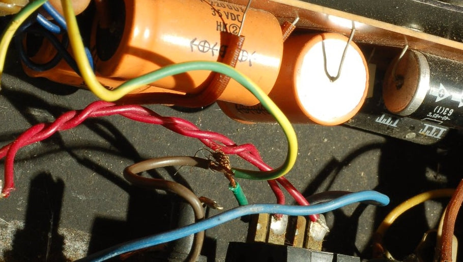

While most failed audio and musical instrument repairs I have come across are indeed not as life-threatening, a few weeks ago I came across the world’s worst repair job and the most dangerous attempted audio repair I have ever come across.
It could perhaps even be considered a murder attempt!
I guess many of you will have encountered hi-fi equipment that is not performing as it should, and still doesn’t even after a trip to the repair shop and half a month’s pay relieved from your wallet. It gets a bit worse with studio equipment, but it is especially bad when it comes to musical instruments. So, I received this call from a friend who had bought a “restored vintage synthesizer,” which he initially described as, “I think there might be something wrong with it.” When it arrived in my lab, it was obvious that it had been badly bodged by someone clearly not qualified to carry out this type of work.
Never use a fuse of the wrong rating!
The two-prong power socket that had been fitted was unsuitable for equipment requiring an electrical ground and the chassis had been badly butchered in the process. The fuse installed was a 3.15 amp fuse, instead of the 315 mA indicated! My friend then added the best part: “I got a bit of a shock when I touched it!”
WARNING: The following picture may cause severe discomfort to sensitive, technically minded individuals.
Notice the three bare wire ends twisted together (to the right of the twisted-pair red wiring) with no soldering.
Opening up the power supply, we found some bare wires loosely twisted together, not even soldered. The fuse had been entirely disconnected (the round black housing with no wiring connected to it)! In European electrical color-coding, brown is the live wire, blue is neutral and the green/yellow wire is ground.
So, not only was an incorrect two-prong socket fitted, but the chassis ground had been twisted together with the live wire, essentially hard-wiring the 230-volt AC line to all of the exposed metallic parts of the instrument, and with no fuse in the circuit! According to the electrical codes in most European countries, the electrical outlets in the wall can deliver 16 amps, 13 amps or 10 amps of current at 230 Volts AC. And the only thing limiting the current flow would be the resistance of the body of the keyboardist! To put this in perspective, any current exceeding 0.03 amps is already considered potentially lethal.
The frame of the instrument was wooden, insulating the exposed metallic chassis at the top from the building’s ground.
The problem would not become noticed until somebody touched the chassis, which could then very well be the last thing they ever get to touch.
In theory, the electrical codes usually also call for an RCD (Residual Current Device) to be fitted to all electrical installations, to protect against such incidents by limiting such fault currents to 30 mA. So, why did the RCD not trip at my friend’s band’s practice space when he felt the shock?
Was he just lucky and the current just happened to be less than 30 mA because he simply did not make good enough contact with the chassis? Or was the RCD inoperative (or even entirely missing)? Perhaps another job badly done?
