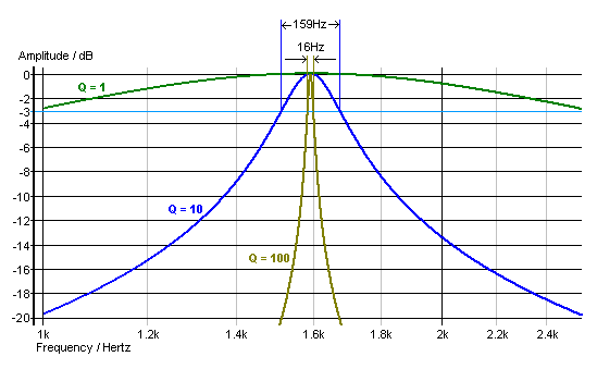

For those who might need an introduction or refresher, what is Q? Most equalizers are graphic equalizers, the type found anywhere from Windows Media Player and Apple Music to the standalone units used by recording studios, DJs and in some home audio systems. A graphic EQ will boost or cut the volume level of a fixed selection of frequencies, usually in one-third-octave ranges. A parametric EQ, on the other hand, can boost or cut any frequency within its control range, and also adjust the bandwidth – or Q – of the selected frequency range. (Technically, Q is the ratio of center frequency to bandwidth.)

Once you have selected your chosen frequency (or octave) you want to edit, this becomes the center of your Q bandwidth. The Q number you choose selects how wide or narrow the bandwidth is stretching out from that center point. You may then use a milder or a greater amount of boost or (often more practically) cut as you increase or decrease the dB level of that Q bandwidth respectively. Parametric EQ may be less easy to visualize unless you have an on-screen display which shows your curve as you edit it in real time – but they are far more flexible and powerful in their refinement of your edits. You can operate with more surgical precision instead of less.

This is where narrowing the width of the Q value may help us to be more specific in our edit. Instead of spanning a one-octave range, which would affect the fundamental notes of the snare, we could try half an octave range, from 375 Hz to 750 Hz. We still have 500 Hz as the center frequency, but now half of the bandwidth than before. Our Q factor for this half-octave slice can be given a value of Q 2.8.
If we wanted to make a narrower adjustment still, we could make a quarter of an octave adjustment with a Q of 5.6, or an eighth-octave with a Q value of 11.2, or sixteenth at 22.4 and so on. The higher our Q number, the narrower our bandwidth adjustment is, thereby allowing for a more specific edit of whatever instrumentation and vocals fall in that chosen frequency range. Or in other words, the higher the Q, the fewer frequencies are affected.

Header image: graph showing parametric equalization. Courtesy of Wikimedia Commons/Matias.Reccius.
