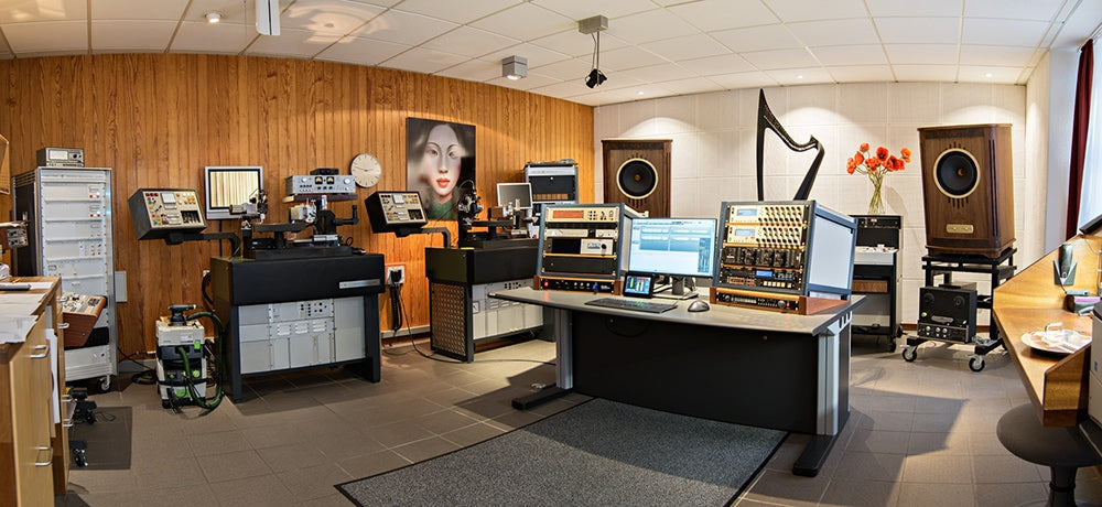

Inés Breuer, Hendrik Pauler, Hans-Jörg Maucksch and Günter Pauler of Stockfisch Records.
On 14-inch blanks this imperfection does not negatively affect the cut, because the disc is pulled flat under vacuum on the Neumann VMS DMM [cutting] lathe. Our 12-inch Dubplate, however, has to lie flat on the turntable of a record player, where only a maximum of 0.6 mm vertical movement is allowed. For this reason, our 12” steel blanks are made flat by means of a roller press which applies several tons of pressure. Not only is this procedure expensive, but we still discard about 30 percent of the blanks as not suitable. That’s why we sell the DMM Dubplate for a relatively high price of 700 Euros. We can only produce about five Dubplates each week, as that’s about the number of good blanks we receive per week.
The music on Vol. 1 comes from a digital master. On our Neumann VMS-82 we have a digital preview delay made by Daniel Weiss that is capable of 96 kHz. We could just as well use an analog tape as source, but it [would] have to be converted to digital in order to work with our machine.
Neumann VMS-82 cutting lathe.
We have played back the DMM Dubplate around 200 times, using test tones such as pink noise. There was no hearable loss in sound and no measurable wear on the stylus. On a regular pressed vinyl there’s a considerable loss of high frequencies after just 50 plays.

Cutting engineer Hendrik Pauler at work.
