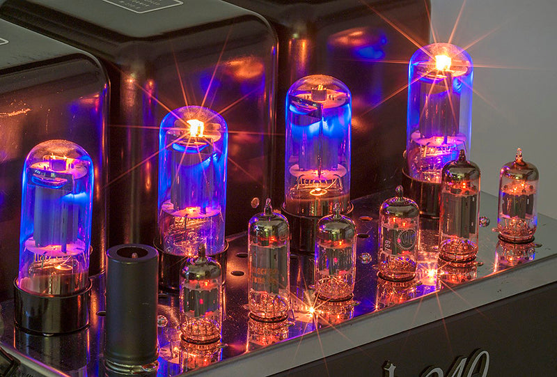

Header image: vacuum tubes in a vintage McIntosh MC240 amplifier. Courtesy of Wikimedia Commons/Sebastian Nizan.
