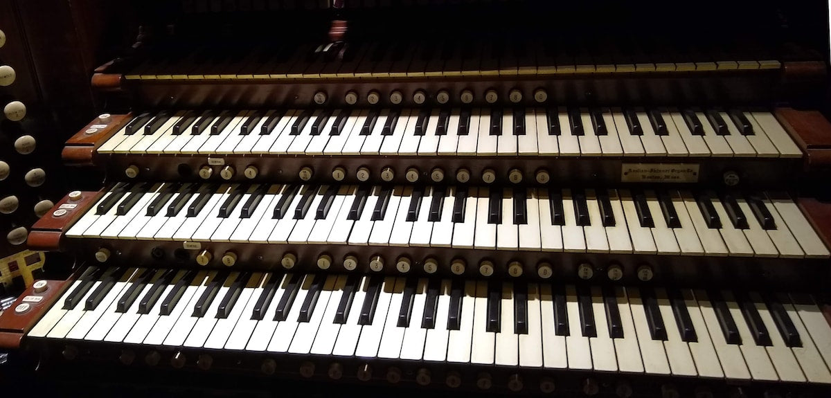

The three most glaring playing challenges with Calvary’s Aeolian-Skinner organ are:
  • Latency of varying milliseconds across all four of the keyboard manuals, making any kind of staccato playing virtually impossible;
  • Temperature sensitivity of the metal pipes within the 200-year-old stone and wood church. The pipes can vary individually from A440 standard concert pitch anywhere from A427 to A442.
  • Access to stops that were inoperable to blend with the ones that were still in use.

Better matching between the virtual and actual Aeolian-Skinner organ sounds and controls was the first goal in Kamel’s plan to bring the Calvary organ back to fully functional status. Even if it was a “cyborg” hybrid, Kamel’s desire was to next incorporate the bass pedal sounds and other stops, along with other MIDI controlled sounds.
Kamel’s four-keyboard manual signal chain first runs from the Calvary Skinner organ, locked to a MIDI clock while the MIDI out is split between a Hewlett-Packard 2420 PC running Hauptwerk’s CCARB, and a MacBook running Spitfire Audio Eric Whitacre choir, Symphonic Strings, Hans Zimmer percussion and Logic Pro X software. His display monitors are all touch sensitive.
Where it all comes together.
These MIDI signals are connected through a Korg Nanocontrol Studio MIDI controller and an Akai APC40 Ableton controller.
As Calvary’s Skinner organ bass pedal foot pistons were never retrofitted with MIDI capability, he has added a Behringer FCB 1010 MIDI controller (with custom mounting frame designed by church elder Jeremy Coleman) and a Studiologic MP113 velocity-sensitive bass pedal unit. The Behringer controller’s MIDI signal is separately fed to a Focusrite Scarlett interface and then to the CCARB software.
With Calvary’s Swell manual only 25% functional and the Gallery, Great and Choir manuals even less so, the CCARB software is crucial at the note origination level for fleshing out the missing overtones and recreating vital fundamental tones in the organ music repertoire.
Additionally, while all the basic Skinner stops in Calvary’s organ still function, Kamel cannot add any additional colors to the sound due to the pipe disrepair, so the CCARB is crucial for supplying 32-foot, 16-foot, 8-foot and 4-foot octave tones as needed.
