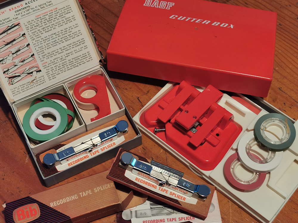

It goes without saying that tape deck maintenance – such as cleaning the heads and pinch rollers, periodic demagnetizing, etc. – are essential practices which (circa-2022) only come naturally to studio denizens and habitués, or those music lovers who never forsook open-reel tape. Muscle memory being what it is, I soon reacquainted myself with the ins-and-outs of the regimen, most crucially including splicing. I suspect the same is true for any returnees. Such is the importance, however, of all open-reel-tape-related procedures that I mischievously choose to use them as a cudgel with which further to discourage the unwary from investing in the format this late in the game. Actually, it’s selfish rather than mischievous. I simply do not want to shoulder the blame for inspiring someone to buy, say, a Technics RS-1700, who finds out that there’s an irreplaceable chip the failure of which will render the deck useful only as a boat anchor or doorstop. Caveats aside, however, this is not a primer in tape hygiene, as I presume a certain level of experience among Copper readers. If, on the other hand, you are completely new to open-reel tape despite years as a hi-fi enthusiast, I would steer you or indeed any R2R virgins toward Issue 324 of The Absolute Sound (February 2022), which contains Robert Harley’s superb in-depth primer explaining the basics. Beyond that article’s usefulness, it is also a statement of great import for, in and of itself: TAS’ devotion of this much space on the topic of a virtually-defunct format, in a leading contemporary high-end hi-fi print journal, tells me that the revival is, at the very least, noteworthy. Although his article focuses on the workings of reel-to-reel tape decks and even the actual composition of the tape medium itself, Robert does, however, raise the thorny topic of frequency. Not as in 20 Hz – 20 kHz, but as to how often one has to dig out a demagnetizer, Q-Tips, alcohol, machine oil, rubber cleaner, or other housekeeping tools and potions. As one who cleans pinch rollers more frequently than heads, I was jarred by his suggestion that cleaning might be advised after each play. It made me wonder if I had been destroying tape decks, however inadvertently, due to sloth. As for regular demagnetizing, again, the frequency is debatable, but a tape sage I know suggests “every 50 hours” or, more helpfully, once a month. Why this is so important both to returning hobbyists and newcomers is because of the variable state of the machines on offer. I am lucky in that I had four or five decks languishing in a storage facility when the bug bit me. More encouraging for me is access to a brilliant tape deck restorer. Although I have since purchased a couple of machines without his prior approval, one from eBay and two from the Tonbridge AudioJumble, I was blessed in that all three were functioning perfectly. That said, all of my machines (especially the ones that hadn’t seen use in decades) have been serviced. Harsh is the realization that you really don’t know what you’re getting when you buy anything other than a fully-refurbished machine, usually at great cost, from one of the established restorers. The preferred models for revivification include assorted TASCAMs and TEACs, the Technics RS-1500, the nearly-ubiquitous Revox A77 and B77, and most of the better Sony and Akai models. Remember: I am talking solely about domestic and, in the case of some TASCAMs, semi-pro machines, not ex-studio gear. Although every one of my mentors swears by Studer A800 Series decks, that suggests having a diet of exclusively 1/2-track tapes. (Note to those who may not have read earlier installments: I undertake absolutely no recording, and play only commercial tapes of pre-1980s vintage. I am not in the position to purchase the $250-plus current fare. Thus, I am concerned only with machines that play 3-3/4 ips and 7-1/2 ips 1/4-track tapes, though I have acquired around 50 vintage 1/2-track 7-1/2 ips tapes. Pro machines have been discussed in Copper in previous issues, the articles written by far better qualified commentators.) Despite the list of the usual suspects, there is no suggestion that you’re restricted for choice of pre-owned machinery. If anything, the selection is vast, and I learn of obscure manufacturers on a regular basis. Best of all, the online marketplace is awash with affordable, excellent Sony TC377s, Akai 4000Ds, TEAC’s 7-inch-capable X-3 and X-7 (or a bit more for the X-10 if you want the larger spool size), the delightful Pioneer RT-707 (currently on a vertical price trajectory), assorted Tandbergs, etc.
