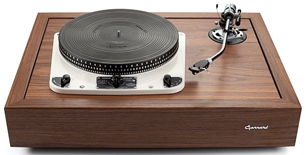

Adrian Wu's completed Garrard 301 with solid cherry wood plinth, Tenuto gunmetal turntable mat, modified SME 3012 Series II tonearm and Ikeda 9TT cartridge. Adrian Wu's completed Garrard 301 with solid cherry wood plinth, Tenuto gunmetal turntable mat, modified SME 3012 Series II tonearm and Ikeda 9TT cartridge.
In 2018, SME announced that they had bought the Garrard trademark, as well as the Loricraft company. The following year, they showed a “new” original 301 built with New Old Stock (NOS) as well as remanufactured components. The plinth follows the Loricraft design, which has a top plate supported by four rubber mounts, similar to the Roksan. The machine is only sold with a 12-inch tonearm, a descendent of the 3012. I have not seen an official price yet, but have heard various estimates from £12.5K to £20K.
